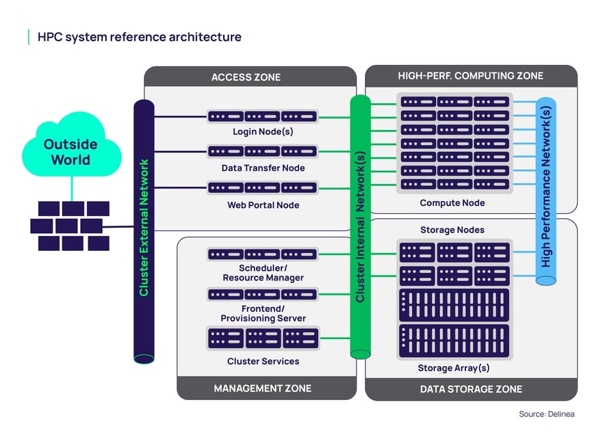

NIST's guidance emphasizes a zone-based architecture (isolating access, management, compute, and storage zones) and enforces role-based access and least privilege across those zones. It also highlights strong authentication, software governance, and comprehensive auditing to address the performance and scale of AI environments. The table below highlights the important controls of NIST SP 800-234.

HPC system reference architecture
NIST's HPC overlay makes it clear that identity-centric controls are non-negotiable in high-performance AI environments. Following these tailored controls allows you to create zone-isolated, least-privilege ecosystems where every account, process, and dataset is governed. The overlay effectively puts an "umbrella" of best practices over all your AI factories, ensuring that fundamentals like account management, authentication, and auditing are never sidelined even at extreme scale and speed.

NIST's zone-based approach directly helps here.
  • For example, enforcing that users enter through an access zone and only reach GPU compute nodes via a scheduler limits exposure.
  • Similarly, using a dedicated management zone for administrators and requiring separate admin accounts (preventing AI jobs running as root) cuts down on the blast radius of any one account.

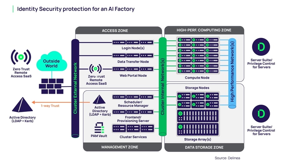

Applying Delinea PCS and Server Suite to secure AI factories
In practice, Delinea's Privilege Control for Servers (PCS) and Server Suite bring all these capabilities into an AI factory deployment:
1. Seamless AD/Kerberos identity integration across AI compute nodes, storage servers, and orchestration tools, ensuring one source of truth for user identities and credentials.
2. Automated service account onboarding and key management (for example, programmatically creating Kerberos principals for AI services and rotating their keys), eliminating weak static passwords.
3. Zone-based access control using AD groups to restrict who can access what (for example, only admins can log into management-zone nodes, only data scientists to the access zone), enforcing need-to-access principles per NIST guidance.
4. Privileged session management with MFA. Administrators must use MFA t o elevate privileges or access critical systems, drastically reducing the risk from stolen credentials.
5. Secure, Kerberized NFS storage, integrating identity into storage access (NFSv4 with Kerberos) so that data access on the AI factory's shared file systems is authenticated and logged per user or trusted client, preventing a data free-for-all on the cluster storage.
6. Detailed audit logging and session recording for all administrative actions and authentication events, feeding into SIEMs or dashboards for real-time monitoring.
7. Detection of shadow AI or privilege abuse through policy-based controls and analytics (Delinea's identity threat detection), flagging anomalous service accounts or processes that deviate from normal usage (for example, an AI process trying to access unauthorized data or a new unapproved model training instance spinning up).
Identity security protection for an AI factory
By leveraging these controls, you can directly map to the NIST SP 800-234 controls and mitigate the risks unique to AI factories. A scalable, centralized platform handles the heavy lifting of identity security often overlooked in high-performance environments.
